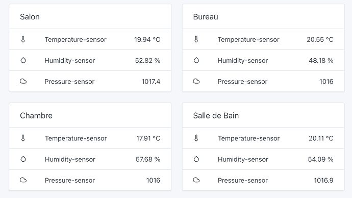

Integrating my sensor in 10 seconds, honestly, that’s excellent!
However, if I integrate it on the home screen, I see « my sensor’s name - opening-sensor » which I think is the device category.
Great service.

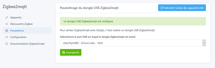

I still have an error (but this time the Zigbee key is correctly detected):
Zigbee2mqtt container failed to start: Error: (HTTP code 500) server error - Cannot restart container b4e181c1c2c85eea5ba156fc7fcddb3707cfc10d1b25d12016b942380200aa35: error gathering device information while adding custom device "/dev/ttyACM0": no such file or directory

In the web interface:
It can be seen that ttyUSB0 is selected, but in reality, in the logs, it is ttyACM0 that is being used and causing the error.

Nope, it’s on my raspberry pi in the electrical closet since yesterday :slight_smile:
And the system does detect it on ttyUSB0:

The zigbee2mqtt container config is not good and is not updated.
Either you modify it manually, or you wait for a fix from @Reno
I’ll modify it in the meantime :slight_smile:
I found the file /src/server # vi /var/lib/gladysassistant/zigbee2mqtt/mqtt/mosquitto.conf in the container, but nothing related to ttyACM0.
Any idea which file to modify?
Found: it’s in /var/lib/gladysassistant/zigbee2mqtt/z2m/configuration.yaml:
