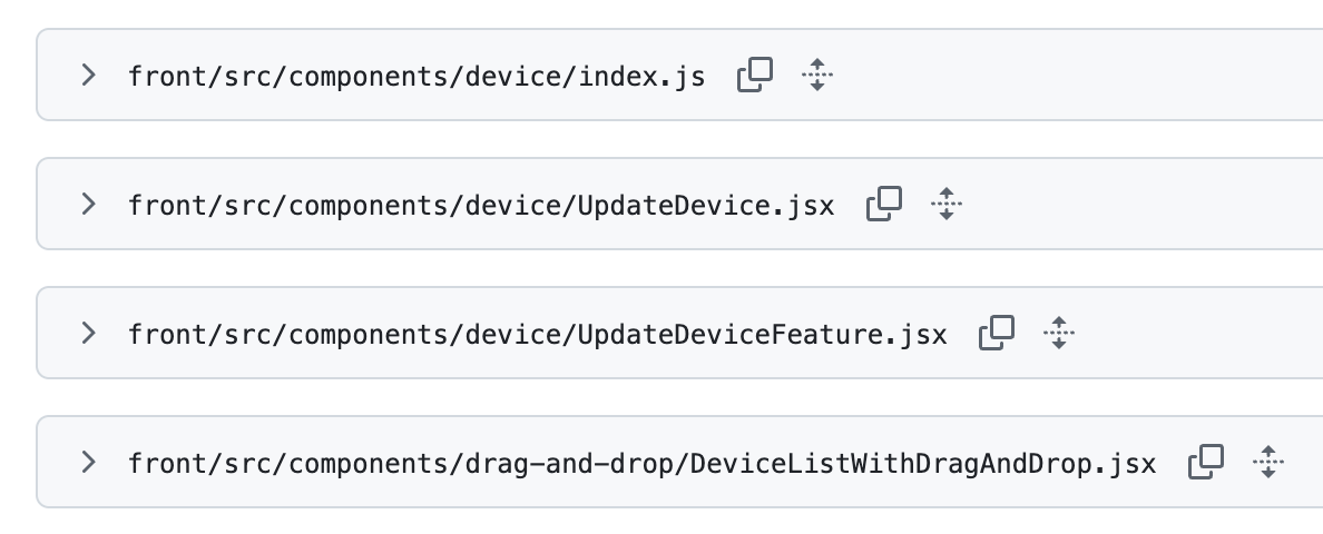

I had a quick look at the PR and it seems to touch more things than just the date re-calculation.
For example, the first four files appear to be leftover from another PR:

The PR branch started from the Tasmota branch, which has had quite a few changes following our discussions.
  • After updating the PR once Tasmota was merged, I went over it again, but I missed the file ‹ front/src/components/device/index.js › which still includes the creation of device conso/cost => I don’t understand how I missed it; it’s the first file and it’s a big one. It’s removed
  • front/src/components/device/UpdateDevice.jsx and front/src/components/device/UpdateDeviceFeature.jsx were adding a shortcut from features that had associated consos/cost to go directly to the energy tracking page. That can be proposed later; I removed it.
  • front/src/components/drag-and-drop/DeviceListWithDragAndDrop.jsx: the component is used in the selection of devices to be recalculated. There was a need to add an inability to change the name for this use.
