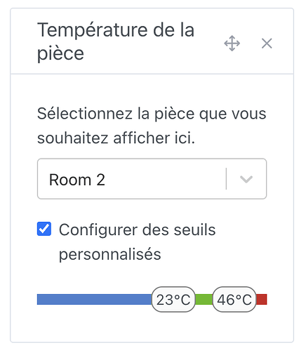

Improvement of the Room Temperature and Humidity widgets
Default radiators offer a « frost protection » mode at 5°C.
So for a room temperature, it seems logical to set it from 5°C to 40°C (with some margin).

We have min/max values that are in the features, and I don’t think they’ve been used so far. It seems to me that they would play a big role here!! IMHO, the bar should take these values into account for the scales. The same will apply (maybe one day) to power sensors, etc.
I just changed the min and max values
I also added the °C in the editing and the conversion when displaying in °F

I just tested, however I can’t display the temperature in °F in the editor; it’s still in Celsius?
Yes, I had forgotten to commit the changes :frowning:
I based it on the user preferences

Right now, all the rooms are red and my wife finds it anxiety-inducing :sweat_smile: I’m going to raise the thresholds
