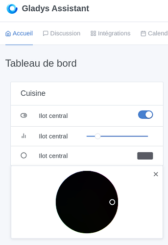

A big thank you to everyone, certainly including @AlexTrovato, because my LED strip is now perfectly controlled by Galdys (my wife complains, but I don’t care: the kitchen island now has a beautiful dark blue in the early evening and turns red in the morning…). Two questions now arise: the color selector display is not great at all, it’s almost black, and the colors don’t really match. On the other hand, how to achieve a smooth transition between two colors over a given duration?

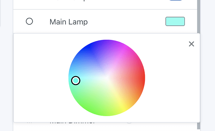

Are we talking about this picker:

Good evening @pierre-gilles,
Here is the screenshot obtained just now from the object placed in the dashboard, on which we can see the absence of color gradient:
The module that controls the banner is a HomeAssistant module bought on AliExpress, whose firmware has been replaced by a Tasmota (version 9.4.0 currently) and which is configured as an AriLux LC01 module. If I go through the module’s WEB interface directly, I do not find any reference to a transition configuration… This may be something to consider if it interests someone other than me? Otherwise, could it be « scriptable Â», either in a dedicated module for a language dedicated to Gladys with an editing interface, or by going « under the hood Â»? I was also thinking of a transition or variation in light intensity depending on a possible room light sensor, to avoid glare at night, for example…

Hi, I’m just dropping by, but this is due to the default value which should not be set. The « last_value Â» does not exist or is equal to 0.

To move the subject forward, I just tested from Chrome on Android, Chrome on Mac, and Firefox on my Mint: same black screen issue… How can I send you a trace that you can use to help me?
Indeed, that must be it. I created an issue to track the bug:
Can you change the color directly on the device via the Tasmota UI?
This should then send a message to Gladys with the color and thus update the « last_value Â».
