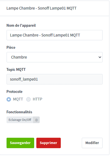

Also, when I send « Turn on the bedroom light » I get the response « I’m turning on the light » followed by « I couldn’t turn on the light »
This light is an E27 Sonoff Slampher RF Tasmota socket configured with MQTT and which works perfectly with my scenes or buttons on the dashboard.
It does the same with my Sonoff Tasmota plugs.
It worked with Telegram before I reconfigured all my Sonoffs to MQTT (they were on HTTP before).
Thank you in advance for the help!
