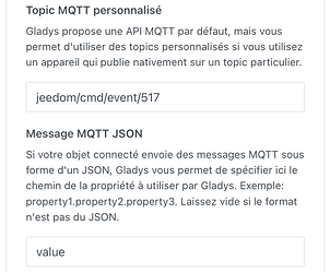

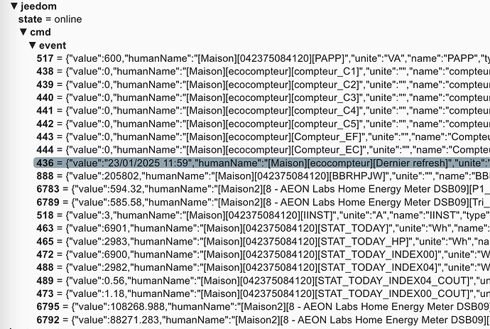

My Gladys MQTT retrieves the value of PAPP, which is pushed by Jeedom as soon as there is a change.
Can someone tell me if this is serious or not, if I made a mistake, and if there is anything to do?
(knowing that I correctly retrieve the PAPP value and that I display it on my dashboard with the MQTT Topic to publish)

If I’m not mistaken, it’s because you have other properties in your JSON that aren’t used, so it’s looking for features that would have those properties but doesn’t find any. It only finds the feature that uses the ‹ value â€ş property.
I think so ^^
So normally nothing serious, it just produces logs. If everything works for you, it’s good. If you don’t use this topic/MQTT message anywhere else, you can remove the properties so you shouldn’t see them anymore.

The error comes from here:
@mutmut Do you have other places where you’ve defined this same custom MQTT topic?

I was referring more to the MQTT integration side — did you have multiple devices to which you attached that same custom topic?
Are we talking about the custom MQTT topic?
If so, then it is only used once.
And for your info, this one is the first on my device, which has 10 custom topics in total.
As I recall, I had to create several topics using the same custom MQTT topic but fetching a different message and notably by putting humanName and name instead of value. However, I deleted them, but I saw a post saying there could be « ghost Â» topics — that might be my problem.
If I continue with my thoughts and especially my initial tests.
When I create a feature and then realize it doesn’t have the right information inside (like Unité for example) :
I then create a second feature and put exactly the same information as the first into it and save.
The result is that the second feature replaces the first (which saves me from having to delete and then find the new feature at the end). I hope that’s clear enough.
I don’t know whether that’s normal behavior or not, but it’s super convenient :slight_smile:

From what I see:
  • I have 2 sunrise/sunset evaluations at startup: weird?
  • It seems like I am subscribing multiple times to the same custom topics (even though I only have one at a time in my features)
  • A custom topic has an error but I am not using that one at all (« Last Refresh Â»). However, I may have created (then deleted) a Text feature to retrieve the value of this topic which is text (unconclusive test).
Indeed!
That’s not normal behavior :joy: Rather a bug
No that’s normal, you must have 2 houses in Gladys, right? The sunrise/sunset is calculated at each house’s location (normal, it’s not the same everywhere)
Ok, there must be an issue on that point. We need to be able to reproduce it.
I think @Terdious is already able to reproduce your first crash; I think we’ll know more after he has investigated.
We don’t handle text types :slight_smile: But that can be changed → feature request (there might already be one)
thanks to the bug then, I love it :rofl:
Exactly, I added a second location which is to the west and I’m in the east.
I’ll take care of it because I’d like to retrieve texts.
Thanks for your feedback and your analysis @pierre-gilles !
