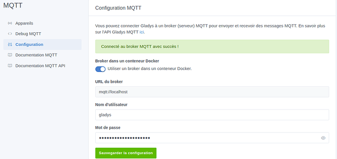

I put quotes around the password and the username as mentioned here
MQTT failed to connect: Connection refused: Not authorized · Issue #11148 · Koenkk/zigbee2mqtt · GitHub
In Integration > Configuration > MQTT
The password does not match the one stored in my zigbee2mqtt configuration.yaml file, is that normal?
I tried changing it but still no connection.

Yes, that’s normal. Gladys launches 2 separate Mosquitto containers, one for the MQTT integration and the other for the Zigbee2mqtt integration; they are not the same broker.
The one for the Zigbee2mqtt integration is available on port 1884.
If you don’t set network=host, it physically can’t work :slight_smile: Gladys must be able to access the mosquitto container.
@pierre-gilles
When you « Enable or disable the service » of « Zigbee2mqtt service configuration »
Does that change the password? I notice it’s not the same as the one I have in production compared to the one I have in my backup. In short, I probably ran all my tests with the wrong password.
This time, with the correct password it worked the second time; the first time I ran into the 600 ms problem.

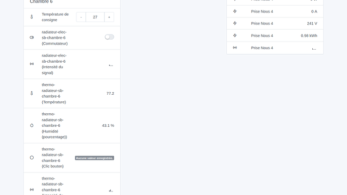

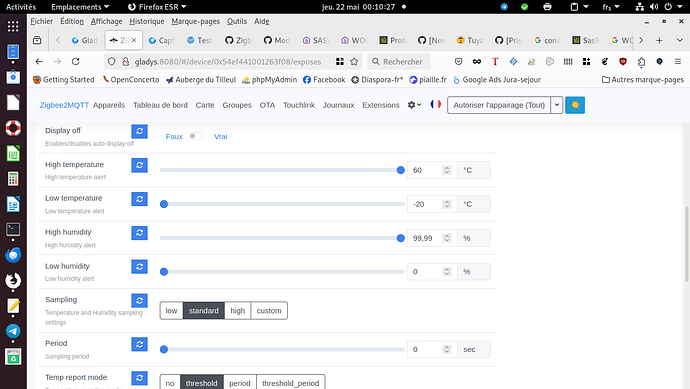

Okay, I started configuring my W100
The goal is to manage the heating of a bathroom electric heater (toaster-style) by the users.
From top to bottom
I created a fictitious MQTT device thermostat which I named:
ref-temperature-sb-chambre-6
The current value is 27° C
Below, the switch NOUS 4-1-20
Which supplies power or not to the electric heater.
Then the signal strength of the NOUS 4-1-20 switch

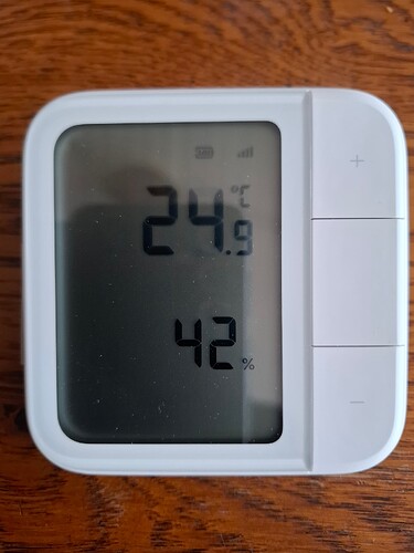

Then the room temperature recorded by the W100 here 77.2 °F (see explanation here)
Then the humidity value recorded by the W100
The middle Click button of the W100
and finally the signal strength of the W100

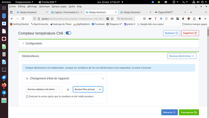

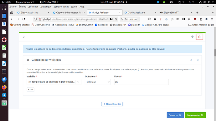

I created a scene Temperature Counter Ch6
with the trigger being the press of the + button of the W100
in the settings I chose Plus button pressed

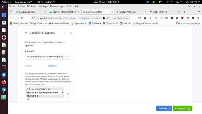

Then I retrieve the reference value of the desired temperature from my fictitious thermostat.
I continue the procedure if the value is less than 35°C
Check that the scene works;
I send myself the retrieved thermostat value via Telegram and wait 1 second before continuing.
I add +1 to my thermostat value
I retrieve the new value of my thermostat
I send myself via Telegram the new value retrieved from the thermostat.
I test it, it doesn’t work.
I change the trigger to a Xiaomi single click button.
That works — the value of my thermostat is incremented by 1: from 27°C it goes to 28°C

The problem probably comes from the (Click button) of the W100 which returns No value recorded on Gladys.
on zigbee2MQTT we have
Button press Zigbee2MQTT result Button release Zigbee2MQTT result
Button + short press single_plus
Center button short press single_center
Button - short press single_minus
Button + double press double_plus
Center button double press double_center
Button - double press double_minus
Button + long press hold_plus Button + long release release_plus
Center button long press hold_center Center button long release release_center
Button - long press hold_minus Button - long release release_minus
In my opinion that won’t work directly because you can’t send a calculation to a sensor.
I suggest you take a look at @prohand’s tutorial on automating the washing machine.
Actually you’ll need to create 2 features for your thermostat temperature: 1 for getting the temp (sensor), 1 to do the calculations (actuator).
In the tutorial it’s called sender (sensor) and listener (actuator).
EDIT: after rereading your post, it seems to work because you get 28 after the +1.
If you send the value of your button to yourself via Telegram, what number does it send back? (it won’t return the z2m result but a numeric value normally)
If there’s nothing then you should create a new topic to add the specs of the Aqara W100 to Gladys.
Here’s what my scene sends me via Telegram when I click the Xiaomi button
And on the dashboard the value of my virtual thermostat has indeed increased.
When clicking the W100 nothing happens: no Telegram notification, the scene is not triggered.
