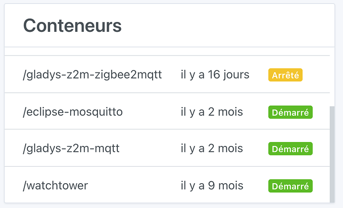

I realize that in the settings the service is stopped and I can’t restart it.
I just did your manipulations! The Zigbee2mqtt container stopped properly after the restart, but the new key could not be validated and the Zigbee2mqtt container did not restart.
As soon as I reinserted the first key installed at the start of Gladys, everything returned to normal (restart of the Zigbee2mqtt container, and the inserted key validated in config).
