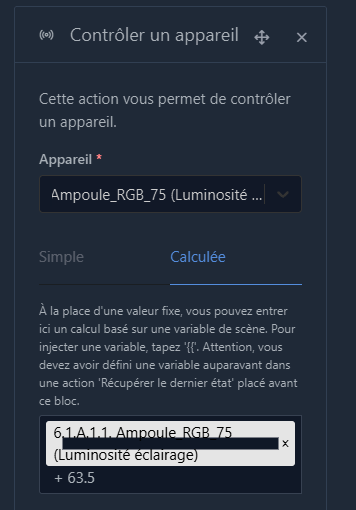

Now that I know what values this button can take (On=7 Off=8 Double-click On=85 Double-click Off=86 Increase Brightness=10 Decrease Brightness=9 Stop Brightness=11), I can’t figure out how to create the corresponding scene: it’s for controlling a light. I’m really clueless!!!
Well, I managed to create a scene (if…then…) for single-click and double-click, but I don’t know how to vary the brightness with long-press on and long-press off (Increase_brightness=10 Decrease_brightness=9 Stop_brightness=11)

It actually works well, but I noticed that the button only sends 4 pulses at a time when you hold your finger down. So to make it vary continuously (by setting the variable parameter to +1/-1), you have to keep releasing the button and pressing it again, etc. I would like it to vary continuously when you hold your finger down (like a classic dimmer switch).
Oh yes indeed, that’s a shame. Did you find a solution in the end?
for now, I’m sticking with 4 levels: +63.5/-63.5!!
but I’m open to any other ideas
