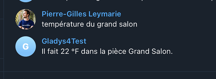

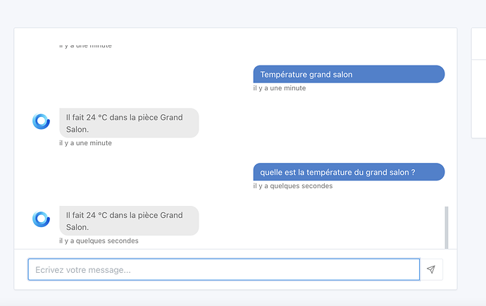

In the chat box, when I ask for the temperature of a room it shows in Celsius, but when I ask via Telegram it shows in Fahrenheit.
I had already made the change in the profile.
I just fixed the bug here:
