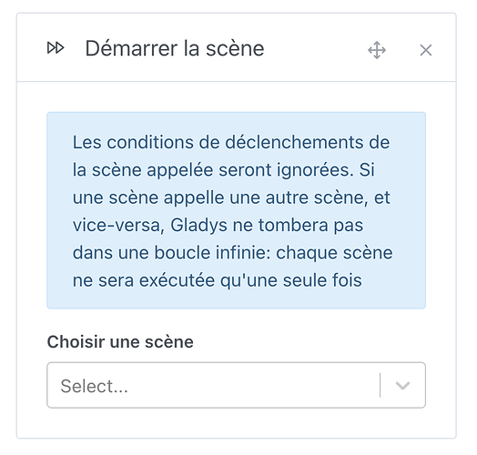

If I could give you one piece of advice, it would be to use the « Start scene » action which would allow you to split your large scene into small blocks, and thus factorize some actions:
For example, at the bottom of your diagram, you have cases that are always the same (target temperature reached or not → turning the pilot wire on or off).
Couldn’t this small block be its own scene?
One advantage of this strategy is that it lets you test each part of your scenes separately, and above all have smaller, more readable scenes.
Be sure to properly name each scene, with a description, and tags so you can find them easily.
