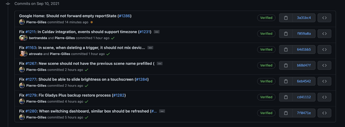

For information, I have made a build on the Docker tag « dev » that includes 7 different bugfixes:
For those who know how to run a dev build, I would appreciate any feedback on this build :slight_smile:
For others, if no one finds anything wrong with the dev build, I will make a release on Monday!

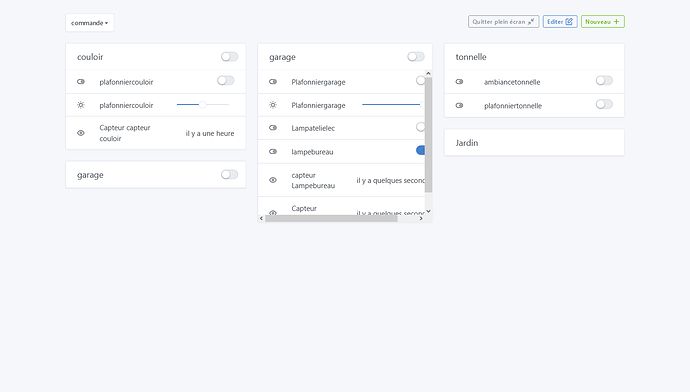

I have displayed devices in a box and now I have vertical and horizontal scrollbars. This is a bit annoying. The vertical one because I have installed 6 devices and therefore I have exceeded the size of the box. For the horizontal one, the scrollbar appears or not, depending on the state of the device. Let me explain, I have a Xiaomi presence sensor, which apparently gives an indication of the time after detection; when it has just detected, it displays in the box: « a few seconds ago », and then the scrollbar appears. After a minute it displays: « a minute ago » and then the scrollbar disappears.
Can something be done about this? :thinking:
Here is the screenshot
I triggered it by adding an element (the 4th) of the same type in a column in a dashboard other than the main one. I don’t know if it’s a coincidence or not.
I was also faster than you, I removed the limit on the vertical size of the « room devices » boxes, so the vertical scroll bars will disappear in the next version of Gladys :slight_smile:
For horizontal scroll bars, you are not the first to complain about them, it’s a typical Windows thing (on macOS we don’t have that), so I always forget to fix it :sweat_smile:
I’ll take a look!

For the horizontal scroll-bars, I will look into it @Psoy, I have created an issue to not lose the bug:
https://github.com/GladysAssistant/Gladys/issues/1295
I would like to thank you once again, Pierre Gilles, for all the work you do and especially for the interest you show in us. And also thank you all for the time you spend answering us when we don’t understand :thinking:. I eagerly await the 4.52 update, which shouldn’t be long now :+1: :slightly_smiling_face:
@Psoy It should arrive during the day, at worst during the night :slight_smile:
For the horizontal scroll bars, I fixed the bug, it will be included in Gladys v4.5.4! I took the opportunity to improve the behavior, now the times update automatically.

@Psoy I just deployed Gladys v4.5.3 which should fix the horizontal scrollbars:
Don’t hesitate to let me know if it didn’t fix your issue :slight_smile:
Great, it works very well, thanks Pierre Gilles :muscle:
