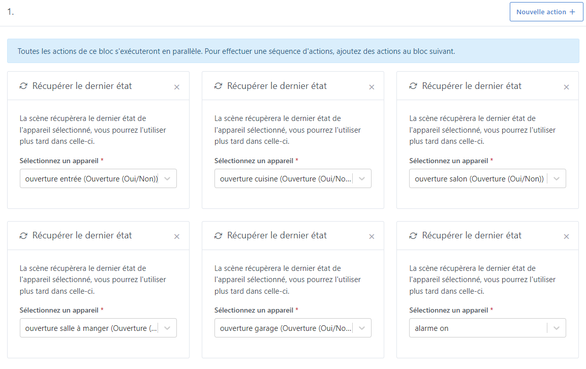

Setting up actions with « Get last state » of the door/window sensors:

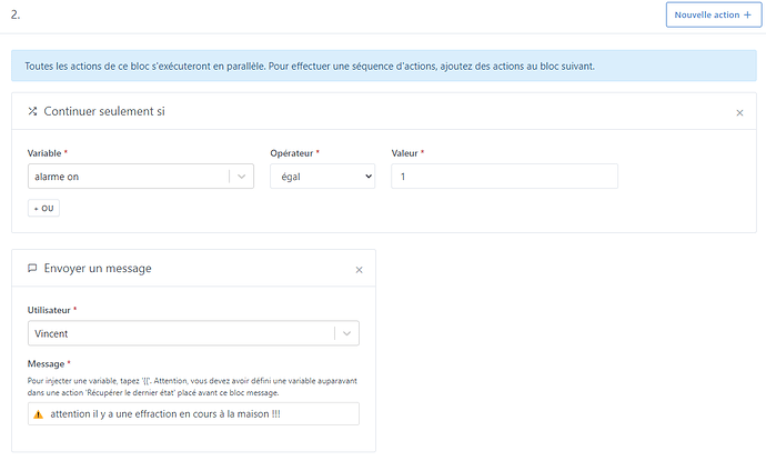

Setting up another action block « continue only if » with sending a message:

Warning: put one action per block otherwise it will not work.
You cannot turn the siren on and at the same time wait 20 seconds and turn it off.
