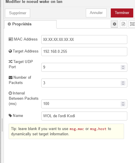

In Node-RED, I installed « node-red-node-wol », and I added the « wake on lan » node into a flow that is triggered by a change of an MQTT topic controlled from Gladys. The node is configured with its default values, and the IP address « 192.168.0.255 » and the MAC address of my mini PC hosting Kodi. For testing, I also have an « inject » node to manually trigger the wake-on-LAN from Node-RED.

Here’s the flow (I just replaced the MAC address):

\n\ntry with the number of packets at 1 and the interval at 500 or even 1000
Hello @cce66. I tested with different NumberIfPackets/Interval combinations (3/100, 3/1000, 1/100, 1/1000), but the problem persists.
Try putting only the « MAC address » and nothing in the « Target Address » (Node-RED should take the broadcast address based on its IP)
Good evening @cce66. I took a while before I could run another test… Thanks for your new lead, but unfortunately that doesn’t solve the issue.
