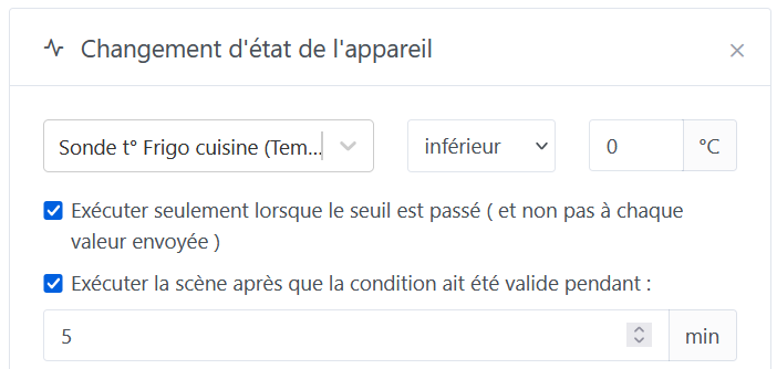

So I have this as the trigger:

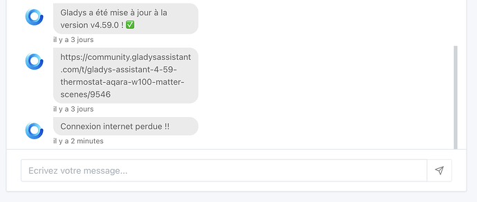

But I observe this in my alerts on Telegram:

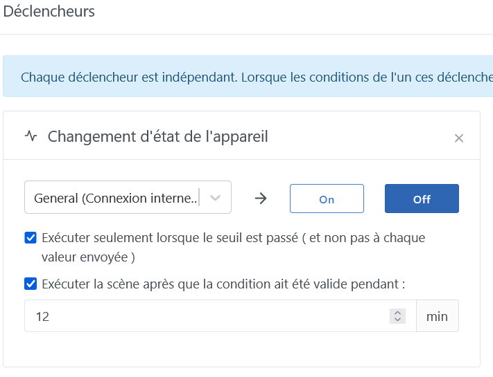

  • In Gladys, a scene is supposed to trigger when the MQTT device goes to 0 and remains so for at least 12 minutes. Here is its config:

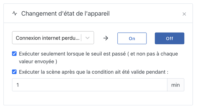

I just ran a test with exactly the behavior you described to me (but reducing the wait time to 1 minute so it’s easier to see)
The behavior works perfectly for me, only one message received, 1 minute after the first 0 was received:

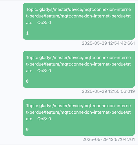

Thanks for taking the time to test, @pierre-gilles. But I’m not sure we’re doing exactly the same test :wink:.
I checked, and my device doesn’t switch back to 1 between two triggers. Since it’s a binary sensor, I’m certain of this thanks to the graph widget that lets you see the start and end of the ‹ 0 › state.

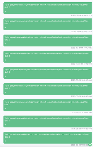

I just ran a test even closer to your case, by sending multiple 0s (during the timeout, and after the timeout):
And I observed the expected behavior! Sorry :sweat_smile:
