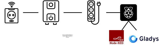

I use 100% Zigbee at home. For this scene, I use two components, one of which is not connected:
Here is a diagram representing (in order): the connected outlet, the UPS, the power strip (for the fiber box), and the Raspberry Pi with Gladys and Node Red.
Why a UPS?
This allows, in case of a power outage at home, to continue powering Gladys.

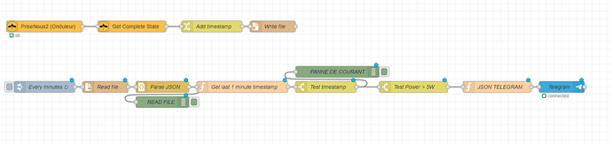

Node Red Configuration
You need to install Node Red and configure the interconnection with Zigbee2MQTT (already covered by a large number of tutorials).
General Diagram
How to do it?
  1. First, store the last value returned by the connected outlet in a file.
    I add the « Get Complete State » block to ensure I have all the outlet data. Then « Add timestamp » allows me to add the data reception date, which I finally store in a file arbitrarily called « prise_nous2_last_data.txt ».
  2. Then I read this file every minute and compare the date it contains with the current time minus one minute.
    The « Parse JSON » block is necessary to be able to use the data stored in the file correctly.
    Then with a function block, I calculate the current time minus one minute:
    Finally, I perform two tests with the two « switch mode » blocks: if the outlet consumes less than 5W or if the date has exceeded 1 minute:
    .png)
    To finish, I create a message to send in Telegra with the last « JSON » block:
