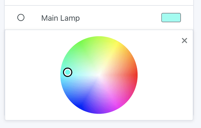

For the colors, you can manage them with the color control that already exists:
You just need to handle a small routine to convert the color format between Hyperion and Gladys (see how other services do it, we already have a few conversion functions).

Well actually it’s great the color picker, I thought I would pass to my Hyperion instance a color type red or blue but not at all, I pass RGB like Hue, so it works directly.
I only have the Effects to manage.
