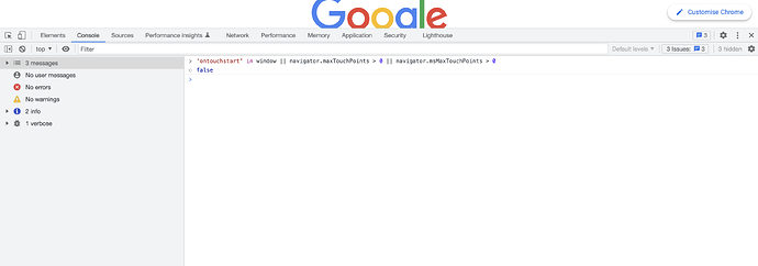

Out of curiosity, if you open the browser console (right-click on a page -\u003e inspect element), and run:
'ontouchstart' in window || navigator.maxTouchPoints \u003e 0 || navigator.msMaxTouchPoints \u003e 0
What do you get?
I’m getting false

Ok, so @qleg and @guim31 the behavior you have is the behavior coded for now:
  • @qleg since your browser exposes that it is touch-enabled, the Gladys front-end chooses to provide the drag-and-drop in touch mode (and not on click; it’s one or the other currently)
  • @guim31 Your browser exposes that it is not touch-enabled, so the Gladys front-end chooses to only provide the mouse interface
In @qleg’s case, development is possible: we’d need to code a mechanism to allow both. We’ll see, this could be simple or it could be a huge undertaking. I can look into it in the coming weeks, but I promise nothing. It’s an edge case that’s really complex, especially since I wouldn’t be able to test it — it would be blind ^^
In @guim31’s case, nothing is possible. If your browser itself doesn’t know that it’s touch-enabled, there’s nothing I can do. You need to investigate; maybe your browsers don’t support touch input on Ubuntu…
