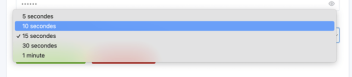

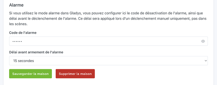

Development progress, added settings to define the alarm code as well as the delay before arming:
For the code, for now I’ve set a 6-digit code.
For the delays, I’ve put 5 options for now:
I can add more if needed!
That’s perfect for me!
