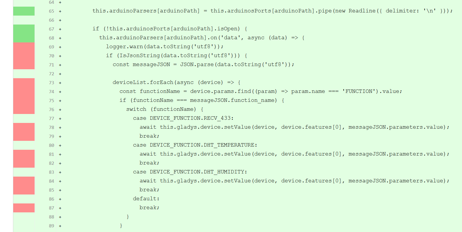

Next, to be able to cover my send and listen scripts, I need to cover the part
 if (!this.arduinosPorts[arduinoPath].isOpen) {
    this.arduinoParsers[arduinoPath].on('data', async (data) => {
of my file. The logic is the same for listen and send.
But in this case, I’m struggling a bit to see how to cover that…
Could someone enlighten me? Thank you very much :slightly_smiling_face:

The biggest part I have left to cover concerns reading and sending data to the card.
Typically, these are functions
port.on('open', function() {});
For example, in server/services/arduino/lib/send.js:
I just can’t find a viable solution to cover this part of the code. And it’s the biggest part I have left to cover ^^
A solution to help me out? :smile:
Great job :clap:
Two complementary solutions:
  • Use a named function that you expose to tests instead of an anonymous function here.
function onPortOpen() {}
port.on('open', onPortOpen);
  • Mock the eventEmitter « port » and call it in the tests
port.emit('open');
This will have the effect of calling the function :slight_smile: Be sure to also mock « port.write » with fake.returns(0); for example.

In my SerialPortMock, I added
SerialPort.prototype.write = fake.resolves(null);
Regarding
port.emit('open');
Where do I call this?
In ArduinoManager.test.js, I modified my JSON send test
it('should send a JSON to the arduino', async () => {
    const sendSpy = spy(arduinoManager, 'send');
    await arduinoManager.send('/dev/ttyACM0', messageData, 1);
    arduinoManager.arduinosPorts['/dev/ttyACM0'].emit('open');
    assert.calledOnce(sendSpy);
    sendSpy.restore();
But then what?
In my case, port is a SerialPort object… I don’t really see how to perform this test :sweat_smile:

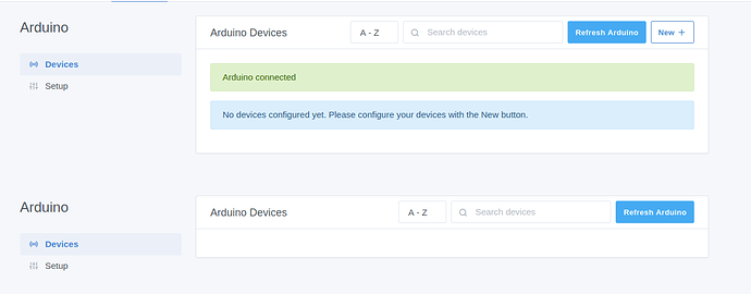

Hello, on the last build (Docker image): the Arduino module no longer detects my USB ports.
I know which port the Arduino is on.
Bus 001 Device 004: ID 1a86:7523 QinHeng Electronics HL-340 USB-Serial adapter
Am I the only one having this error?
I quickly tested it, small bug (right after setting up an Arduino Uno)
Can the feature type depend on the function? I find it a bit silly to select a feature when the function already defines it (light for a Temperature function :upside_down_face:)
