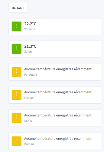

I have an Airzone and I integrated it into Gladys Assistant.
I don’t understand: I have an Airzone with 5 rooms and a TADO that allows me to control a separate Hitachi air conditioner (not Airzone).
When I integrated it into Gladys, it found everything. However, it only gives me the temperature of my veranda (TADO air conditioner) and my living room (room with my main Airzone zone). It finds my other 4 Airzone rooms but says « no temperature recorded recently. » I don’t know where to look.
Thanks for your help if any of you have an Airzone.

Hello @Lokkye,
I did the update but it’s the same
What’s weird is that it finds the 5 zones for me but only one temperature (it also finds the veranda zone which is not an Airzone zone).
I have this in the logs (I restarted Gladys so I think it’s normal that there are connection errors:

Here's what is displayed:

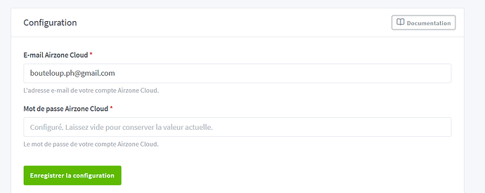

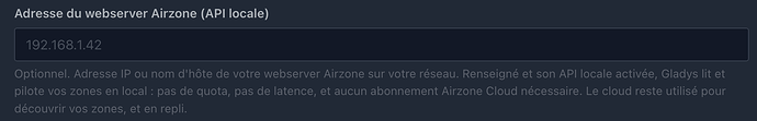

@filbou40 did you fill in this field in the configuration?
If I understood correctly, this is the field that switches you to the local API and not the cloud. :thinking: (I looked at it diagonally, I don’t have an airzone)
uh, in the config section, I only have this:
I don’t have an area to enter an IP address
I just updated the plugin because I installed it a moment ago and I do have this part :slight_smile:
