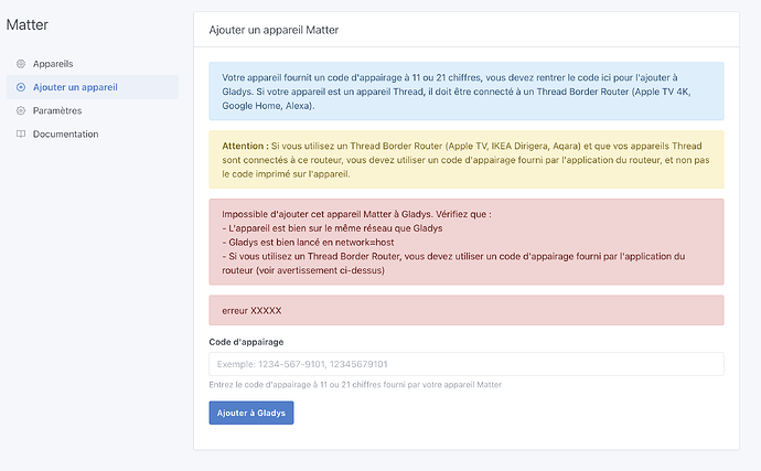

Suggestion — do you think it would be better like this:
In case of error:
The PR: Matter: Make pairing process more clear by Pierre-Gilles · Pull Request #2491 · GladysAssistant/Gladys · GitHub
So that’s not bad.
However, at my level of expertise I can’t say whether it’s really a systematic requirement.
We have G_rom0304 who added IKEA Matter bulbs without this step.
In any case, it’s already better this way.

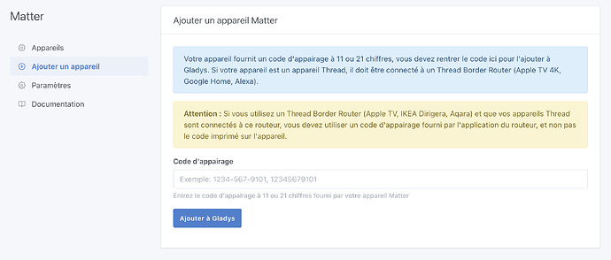

Great! It’s merged and will go out in the next version of Gladys :slight_smile:
UI fixes in the Matter integration are available in Gladys Assistant 4.71:
