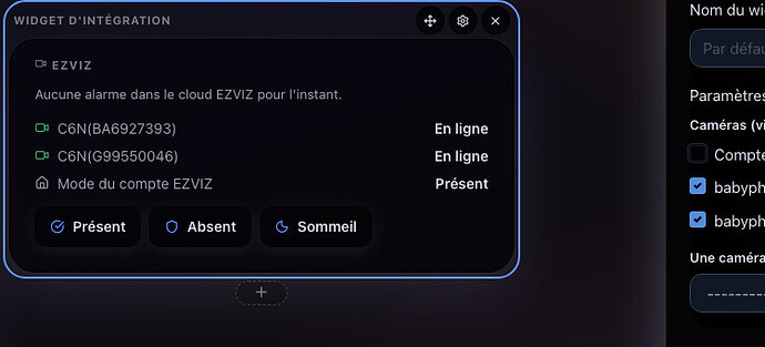

But when I want to Display the RTSP address I have the same code for both cams
Small issue with the widget, you can only select one device, and yet when I click on present/absence, the action is performed on both :slight_smile:
Same, I have no update from the cameras with the basic camera widget
@spenceur thanks for this very precise feedback, it’s exactly what I needed! The 1.1.0 update fixes the three points.
The codes: with « CODE1,CODE2 » without a serial number, the integration couldn’t know which code goes with which camera, and it took the first one for both (hence the same code in your two RTSP addresses). After the update, in the configuration, use the new action « Verify a camera’s code »: you choose the camera, you type the 6 letters of its label, you launch it, and you repeat for the second one. Then empty the old field « Camera verification codes ». The integration now tells you if a code correctly opens the images of the camera.
The widget: the EZVIZ arming is an all-account mode (the EZVIZ app doesn’t have a per-camera mode), that’s why the buttons act on both. The widget now clearly states this, and it can display multiple cameras (new setting « Cameras »).

Can you exclude the ezviz account from the choices? (It’s not even checked and it’s not a camera in the proper sense)
I’ll test the camera update later :slight_smile: Thanks
@spenceur this is fixed in 1.1.1:
  • The widget now displays the names you gave to your cameras in Gladys (your “baby monitors”), and follows your renames. Same in messages and scene variables.
  • For “EZVIZ Account” in the list: I checked, Gladys 5.2.1 offers all devices from an integration in this kind of list, with no possible filtering on my side. I can therefore not remove it, but the widget now ignores it (checked alone, it displays all your cameras).
Nothing to do after the update: your widgets keep their settings. Thanks again for the tests, and let me know about the images!
