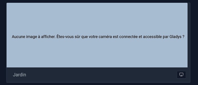

I have an issue with my Netatmo camera not displaying. But if I get the local URL via CAMERA_URL, there is no issue (I add it in the Camera integration for example)
Here is the log in a loop on this:
[2026-08-08T10:08:54.221Z] [WARN] [netatmo-camera] Camera snapshot still exceeds the 96 KB budget after re-encoding — skipping this frame
[2026-08-08T10:10:54.964Z] [WARN] [netatmo-camera] Camera snapshot still exceeds the 96 KB budget after re-encoding — skipping this frame
Hey @spenceur!
Sorry, an old limit was in place because the core didn’t accept them before. Image too heavy.
The core has been fixed but not updated on the external integration side for me.
Claude is taking care of it :wink:
I’ll keep you posted

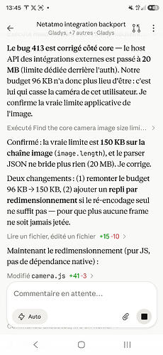

Thanks for reporting, it’s fixed in 1.1.2 :tada:
What was happening: the integration capped camera images at 96 KB — a workaround for an old core limit (the host API was behind a 100 KB JSON parser, which returned a 413 error). Your snapshots exceeded this threshold even after re-encoding, so each image was ignored → no images on the dashboard. Live view, however, worked because it doesn’t go through that path (hence your workaround with CAMERA_URL that works).
What changes in 1.1.2:
  • the core now parses the host API with a dedicated 20 MB limit → back to the real 150 KB budget;
  • if a snapshot is still too heavy even at minimum quality, it is now automatically resized instead of being discarded — a smaller image is better than no image.
    Available in about 1 hour, update the integration (Supervision → Force Update) and the image should appear. If it persists, send me the netatmo-camera logs after the update.

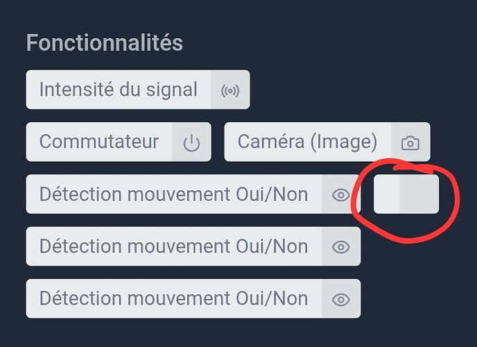

Awesome I updated my device but I have a weird rectangle. Normal ^^ ?
It’s probably Meta-tmo glasses :joy:
It’s just that the feature added by Netatmo is not recognized by Gladys.
