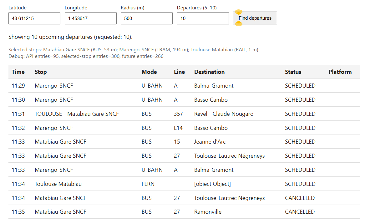

My load test from today… and since I have grown fond of Toulouse in the last few days, I went to 64 Boulevard Pierre Semard Toulouse, better known as Matabiau, for testing.

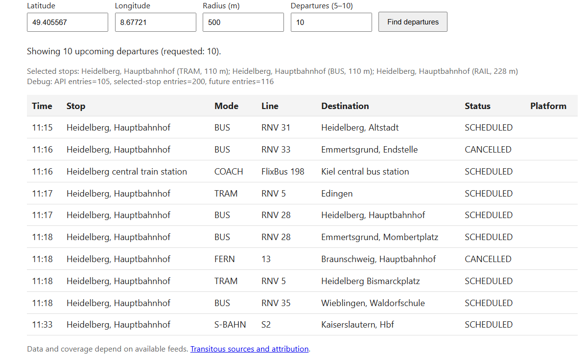

And here the same result for Heidelberg Hauptbahnhof:
Everything included, urban buses (BUS), interregional bus lines (COACH), urban trams (TRAM), interregional trains (FERN), local commuter trains (S-BAHN).

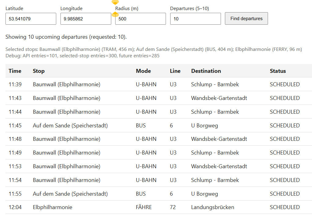

Ferries (FÄHRE) are also displayed, here the example of the Elbphilharmonie in Hamburg:

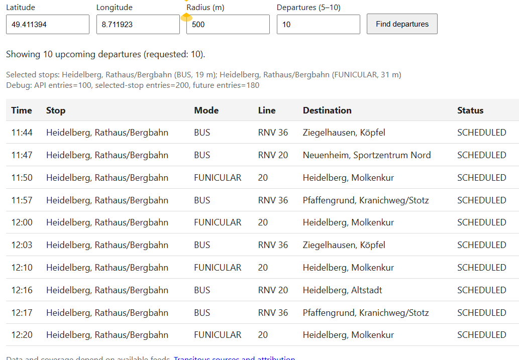

Here is the city of Heidelberg with a funicular/cable car (FUNICULAR):

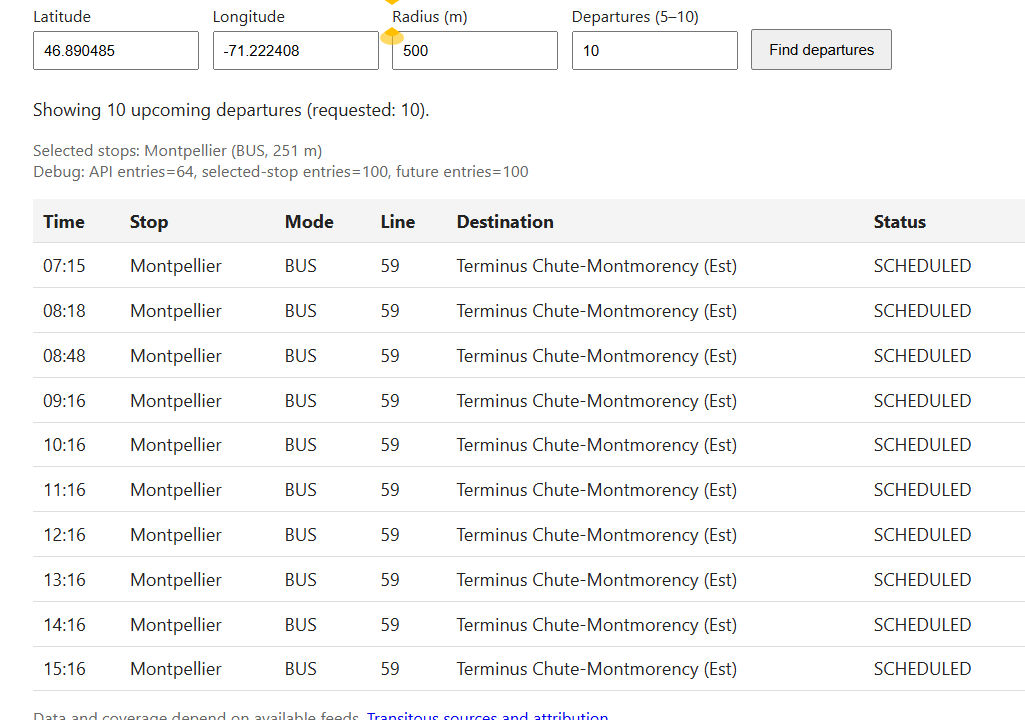

and what about our North American friends, here Quebec in Canada:

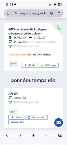

I just found out that the real-time data for the Ginko network in Besançon is on this opendata platform. I’m going to test your integration, and if it works, it’ll be another Node-RED hack I can get rid of!
So actually, the integration does find the Ginko network in Besançon, but it’s only the theoretical schedules in GTFS format.
Real-time schedules are mentioned on the transport.data.gouv.fr website, but in SIRI format. The details explain that it goes through an API requiring a key.
On the website, there’s this:
And the details of the SIRI interface are here: Jeu de données ouvert SIRI - API SIRI pour Réseau urbain Ginko - CU Grand Besançon Métropole

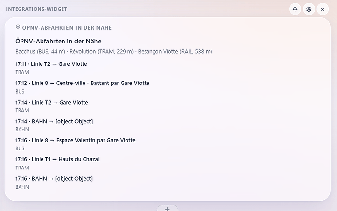

@Guim31: Look here :joy:

Besançon gives me:
Note: I am already working on an object Object. The following settings were used:
47.242222°, 6.021389°
Regards
