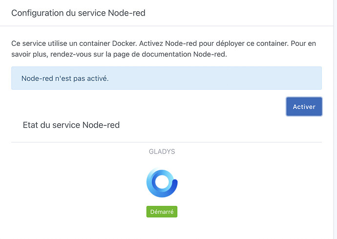

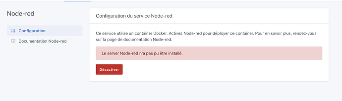

When you click on the node-red integration, you get this:
So, it’s already enabled?
It seems not, because the interface is inaccessible… However:

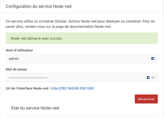

There you go, I did my homework :wink:
First launch, OK

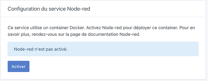

Small typo in the explanatory sentence: ‹ Activez › (rather than ‹ Activer ›, it’s more consistent) and there’s a missing period at the end.

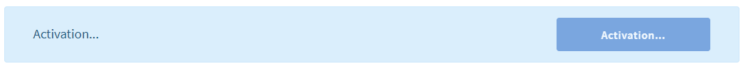

After clicking on ‹ Activer › :
On slower machines, activation can take up to five minutes (tested on RPi2 here). Maybe it would be useful to mention that?
After a few minutes, the page refreshes but the fields are empty :
Small typo: ‹ Désactiver › is missing an accent
After a manual refresh :

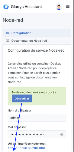

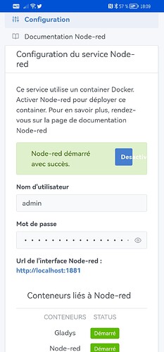

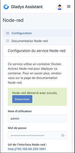

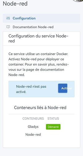

One last thing but I don’t know if you can do anything. It’s the mobile display that’s not great when it comes to the enable/disable button :
Great work in any case!
Thank youuuuuu :slight_smile:
I just fixed it, I now remove the container after stopping it
I just fixed that too. Now the button is not on the second line:

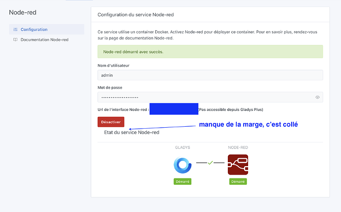

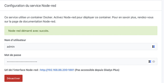

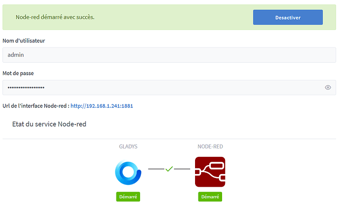

Can you move the « Disable » button and make it red? I don’t find it very visible to put a button in an announcement banner.
I’d put the button at the bottom of the page:
I confirm, perfectly functional.
Button moved as you
@pierre-gilles @GBoulvin
Here is the result with the button moved
I rebuilt a Docker image with the changes :slight_smile:

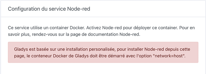

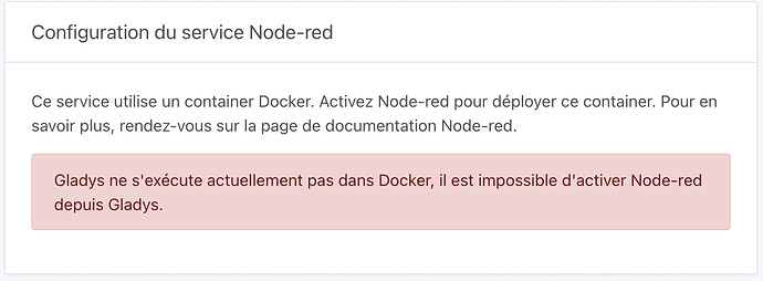

It’s better but I have a few comments/questions:

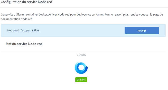

  • Why display « état du service node-red » when Node-RED is not enabled?
  • If the user is not running under Docker or has a configuration that doesn’t allow launching a container, is there a specific message with the « activer » button unclickable?
  • The « Activer » and « Désactiver » buttons might be better on the left, no?
  • How is the Node-RED interface URL calculated? You should specify that this URL is only accessible locally. (notably to avoid confusion via Gladys Plus)

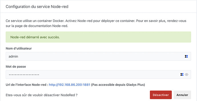

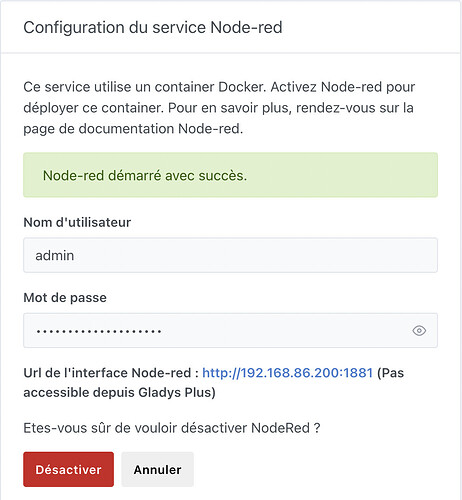

  • For the « Désactiver » button, is there a confirmation before disabling? To avoid destroying everything on a misclick :smiley:

It’s hidden now
Yes
It’s done :slight_smile:
It is based on « config.localApiUrl » plus the port returned by the API

I found the behavior of the « Disable » a bit strange; it jumps from left to right:
Then I freed up my disk and Node-RED started fine:
(Small design remark on the screenshot)

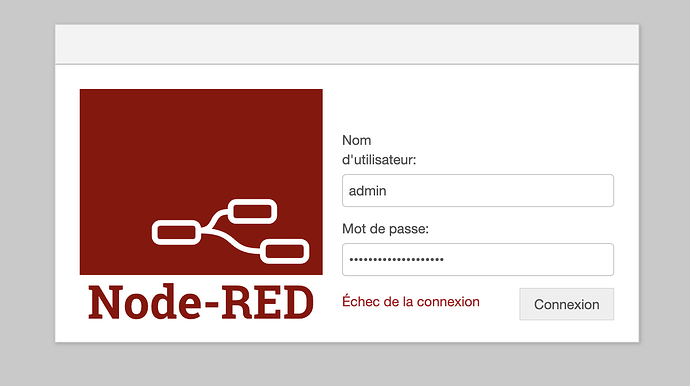

But if I try to connect to Node-RED, I get an error:
Looking at the logs:

I suppose that means the configuration file is still the old one!
So, if I’ve already configured Node-RED once, I’m stuck (I think the old password is still in the file). When testing the hash against the password, it’s indeed not the same password. Do you delete the folder /var/lib/gladysassistant/node-red if the user decides to delete the Node-RED integration?
