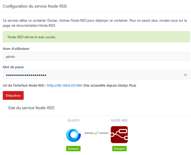

I still have a password issue. Are we entering the values correctly on the page?
nom d’utilisateur : admin
mot de passe : the generated password
Because no matter whether I copy/paste or type these values, I still get a login failure :
That was my reply for that part :wink:
Hello @cce66
you’re a mind reader :smiley:, I hadn’t tried logging in with the password yet. I tried on Chrome, it’s the same. And I checked with about:logins on Firefox, there is no saved password, nor even an address related to NodeRed
Ah, that’s a big problem — some users (notably on Synology or elsewhere) store Gladys in a different folder, so it’s really important that this case works :slight_smile:
But that’s strange, normally your PR detects the host folder, doesn’t it @Lokkye?
oops :wink:
I still can’t open Node-Red with the credentials generated on the Gladys page
:roll_eyes:. Even after several attempts and reinstallation of the delogzway/gladys:nodered image

When I modify my command by replacing
-v /var/lib/gladysassistant_test_nodered:/var/lib/gladysassistant \
with
-v /var/lib/gladysassistant:/var/lib/gladysassistant \
here are the Node-RED logs

I can access the Node-RED page! However I still can’t open Node-RED because the credentials keep leading to a login failure. :thinking:
So I don’t know why — I’ve copied and pasted the password and username at least ten times, but now it works :flushed: here are the Node-RED logs when the credentials work

To get things moving, I stop the gladys-node-red container and have the gladys-test-nodered container active
I access Node-RED at http://ip:1880 without authentication and with my flows that I had created with the gladys-node-red container
Normal or not normal?
They shouldn’t have the same working environment, so they shouldn’t see the flows from the other Node-RED, right?
Well, I just understood that in fact gladys-test-nodered is actually a copy of Gladys that @Lokkye uses for his tests (gladys-lokkie would have been less confusing :slight_smile:)
I’m going to bed — sleep brings counsel! :sleeping:
thanks @cce66 :wink:

Hello @pierre-gilles
For me it works, as I said above, I couldn’t copy/paste the credentials, then at some point it worked, and since then it’s fine. However the filename issue is still the same problem.
-v /var/lib/gladysassistant_test_nodered:/var/lib/gladysassistant \\
with
-v /var/lib/gladysassistant:/var/lib/gladysassistant \\
it works,
Otherwise I don’t open Node-RED, because it keeps restarting continuously
