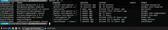

@lokkie @pierre-gilles however a homekit and mosquitto directory is created in the test dir, normal?

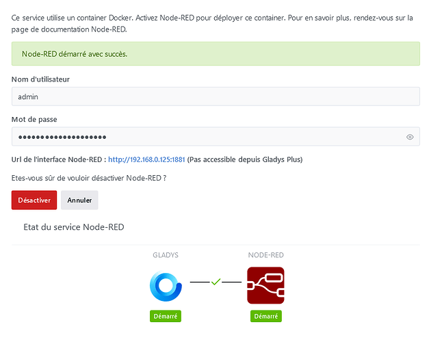

I enable Node-RED

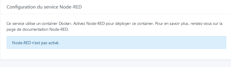

I disable it and I get
I have to do a refresh to get
and be able to activate it again
