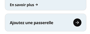

2: click on add a gateway :
3: go through the screens — at this step the gateway must be powered on and connected to the network (an indicator light shows that everything is OK)

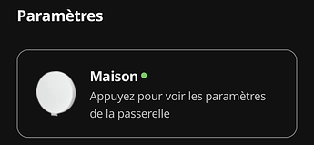

8: in Settings click on the DIRIGEA gateway :

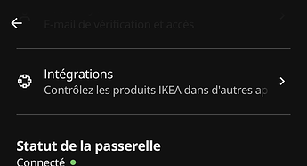

9: choose the Integration option :

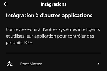

10: click on Matter Bridge :
11: click on get the QR code (this code will be used in step 13)

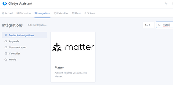

On the Gladys side go to Integrations / search for Matter on the right / and click on Matter :
12: in Settings click on Enable Matter

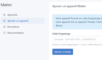

13: in Add Device click on Add a device :
and paste the code generated in IKEA Home Smart at step 11
Tip: if you take too long between steps 11 and 13 you won’t be able to complete this step; once you’re ready to do step 13, repeat step 11 and add the code to Gladys within 2 minutes max.

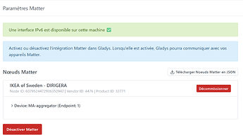

14: our Settings screen now shows our gateway :

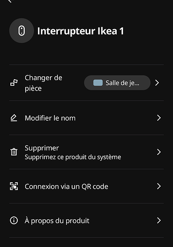

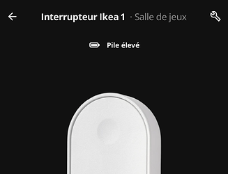

15: in the IKEA app, click on the room where the device is :
16: click on the device :
17: at the top right, click the settings button and choose the Connect via QR Code option :
the app creates a code and its temporary QR code
18: enter this code into Gladys :
