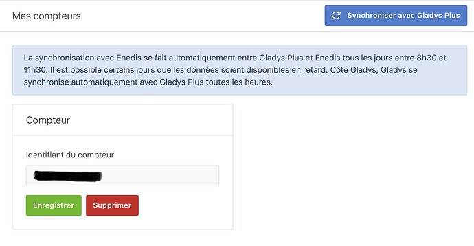

Hello.

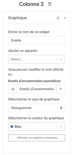

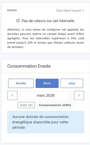

I activated data sharing with Enedis (see photo 3) and I received a confirmation email from them 2 days ago, but the data are not coming through (see photo 2) even though synchronization is taking place (see photo 1).
I have the same thing. I believe it’s addressed in another post.
However, if you click on « Consumption (kWh) Â» you should get the graph for the last few days, right?
No, I don’t have anything.
Hi @micmac,
Two small things to check:
:one: Enedis data
Enedis only returns data once per day, and it’s only possible to retrieve data from the previous day up to the most recent.
So, the “Last hour” view in the charts won’t show you anything with Enedis. You need to switch to a longer period, for example “Last month”.
:two: “Energy Monitoring” integration
For the charts to work correctly, the “Energy Monitoring” integration must also be configured.
I recommend checking that you’ve followed this tutorial:
Don’t hesitate if this doesn’t solve your problem :+1:

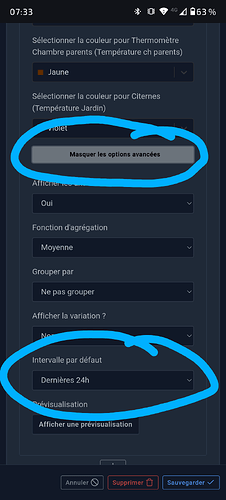

Yes, yes
Click on â€č show advanced options â€ș
Of course you’re right :blush:. I must not have been awake enough this morning :innocent:. In any case, thanks :folded_hands:.
