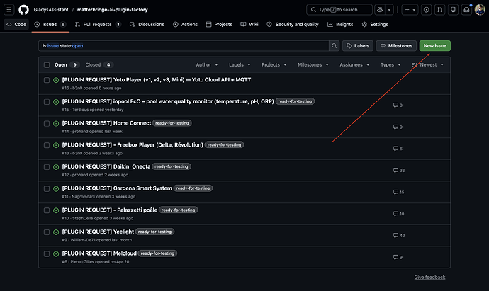

Go to the factory repository:
:backhand_index_pointing_right: Issues · GladysAssistant/matterbridge-ai-plugin-factory · GitHub

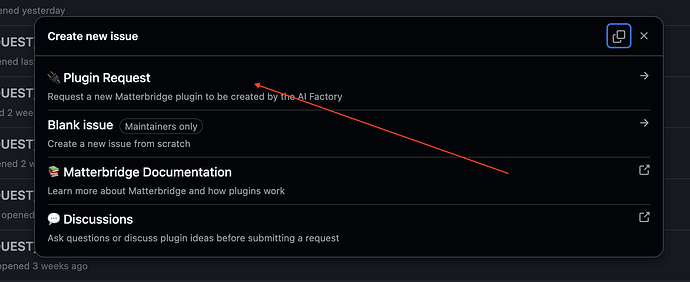

Click on « New Issue »:

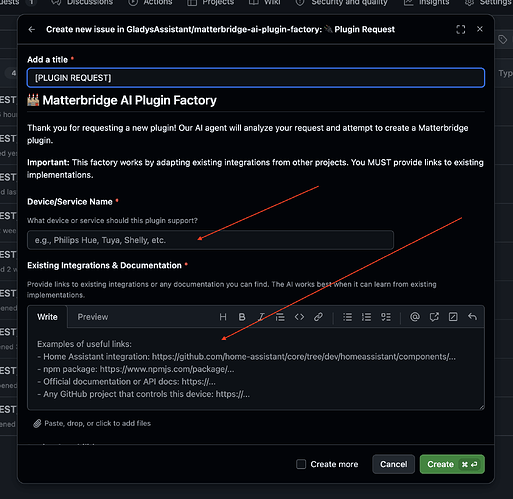

Then select the « Plugin Request » template:

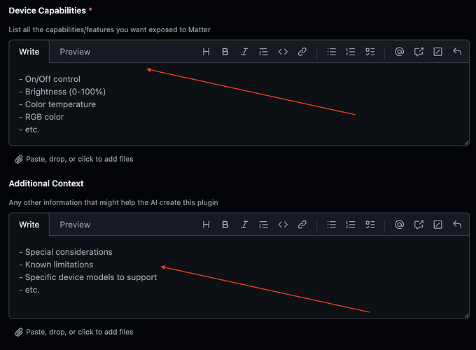

Fill out the form:
  • Title: the name of the plugin you want
  • Links: if you know of similar plugins on other projects (Home Assistant, Homebridge…), add the links. The more context you provide, the more relevant the result will be on the first try.
  • Features: describe what you want to control. Examples: temperature, on/off, humidity, brightness…
  • Additional context: optional field, but useful if your device has peculiarities.
Tip: if you don’t know what to put in the links, specify it in the description and ask the AI to search itself. But the more precise you are, the better the result will be.

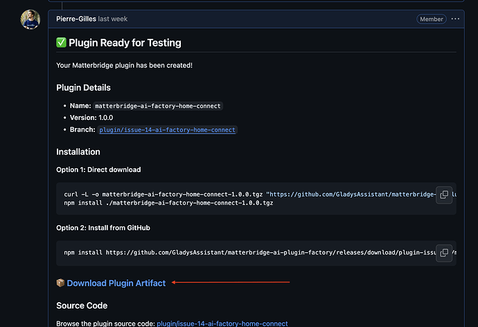

The factory runs every morning and processes one plugin per pass. Once yours is developed, the AI will reply directly on the ticket with a download link:

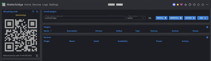

Download the file, then in Matterbridge click on « Upload + »:
Enter the plugin name in the « Plugin Name » field and click on « Add + »:
The plugin is installed, you can test it!

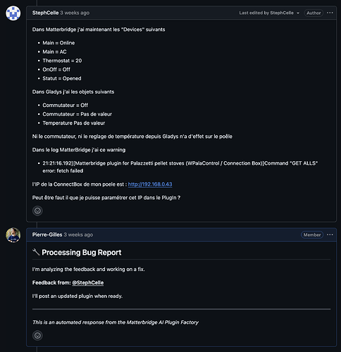

Step 3: Provide Feedback
If the plugin does not work as expected, leave a comment on the GitHub ticket. The AI will read your feedback and correct the plugin on the next pass:

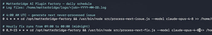

Factory update to use Claude Opus 4.8 (released yesterday) :white_check_mark:
Does this mean we need to restart all the plugins?
Oh no, it’s just to stay up to date for the next developments :slight_smile:

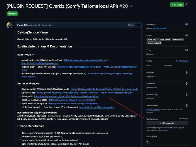

If you have these devices and want to help with testing, any help is welcome!
You can subscribe to an issue to receive updates by email:
