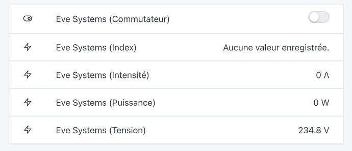

I set up a small test environment with my Eve Energy plug that reports consumption, but I’m going crazy — I managed to get the voltage, current, and power, but I can’t get the energy meter reading:
Because the meter reading is only reported every 10 minutes, testing is very time-consuming — I’ve been on it for an hour and a half :joy:

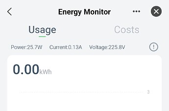

It doesn’t work for me. I have a Nous A8M outlet https://www.domadoo.fr/fr/devices-matter/7147-nous-prise-connectee-wifi-matter-16a-mesure-consommation-a8m.html with power consumption measurement, but I don’t have any data in Gladys.
Here’s a screenshot from the outlet app where I have a consumption of 25W. So the measurement is correct
In Gladys, I only have the Switch functionality
Are all the available functionalities in the JSON?
If I try to understand why, I should be able to find one of the functionalities you added?
