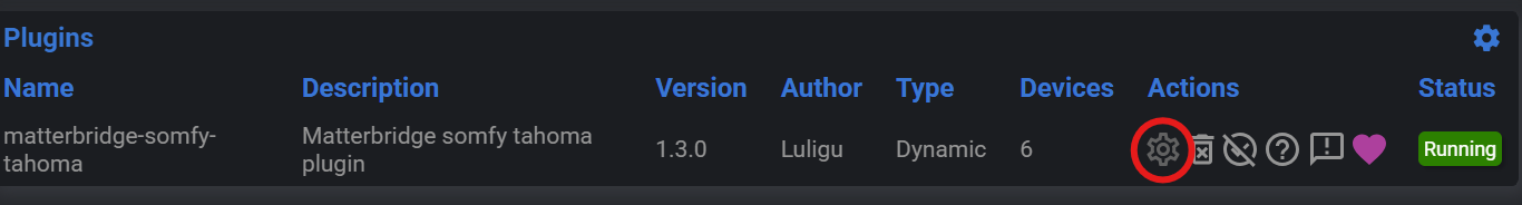

@Herve here’s where to enter the info :
You add your shutter/blind, you set the time in seconds it needs to raise or lower (I think I set the longest time when I had differences of 1 to 2s).
And once you’ve added all your shutters/blinds, the percentage given by the plugin becomes proportional to the time.
It’s not ideal yet but it helps compensate for the lack of state retrieval by having an « approximate » position.

But oddly the plugin’s settings icon is inactive…
I just saw the docs on GitHub — I’ll edit the configuration file…
Weird :flushed_face: … but how did you manage to enter your credentials then?
EDIT: is your matterbridge up to date (3.3.3 currently)?
There we go, it’s good — actually Matterbridge needed a restart…
I’ll be able to record the ascent/descent times.
