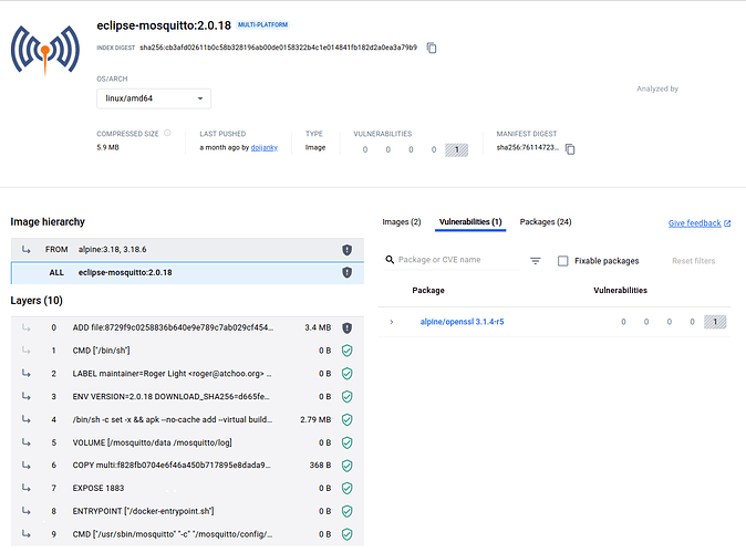

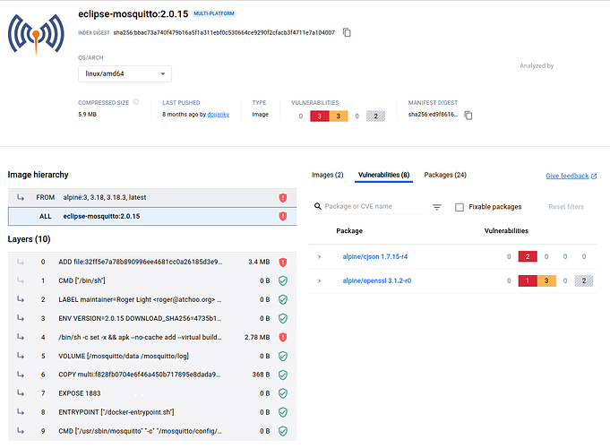

Mosquitto is currently at version 2.0.18 and that fixes several (8) vulnerabilities.
V2.0.15
v2.0.18

There was a bug in version 16, so we pinned the image to version 15
But it’s worth testing 2.0.18, yes, thanks for your PR
