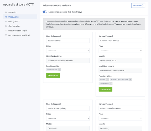

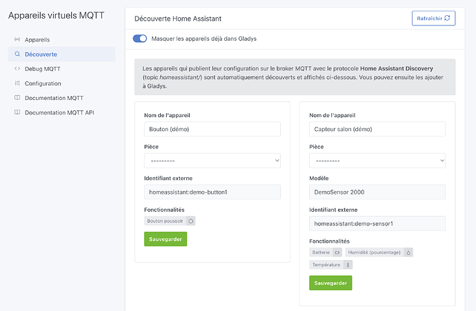

A new Discovery tab appears in the MQTT Virtual Devices integration:
With one click, you can add devices exposed on your MQTT broker by these Home Assistant integrations.
