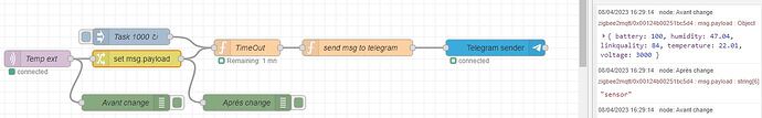

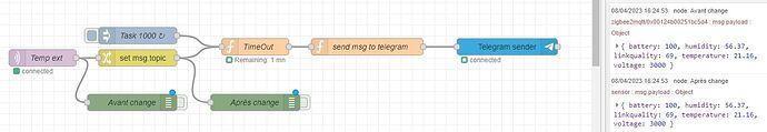

Here are my screenshots :
1 - with msg.topic :
2 - then with msg.payload :
Ok so the topic is indeed transformed into a sensor in the first case.
In your modification you change the payload so that changes the payload. But in the Timeout function, originally it’s the topic that is modified.
At worst, if you prefer the payload you only change line 19 by replacing the topic with the payload.
But for me it’s not necessary because the change block works fine.

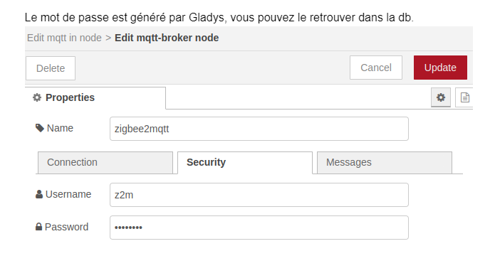

How did you recover this password? :
In the database
SELECT value FROM t_variable WHERE name = 'Z2M_MQTT_PASSWORD';
I’m going to be annoying, but how do you access the DB? :slight_smile:
I think it’s simpler to get that from the Zigbee2mqtt config file, right?
On the command line on your Gladys machine:
cat /var/lib/gladysassistant/zigbee2mqtt/z2m/configuration.yaml
Normally inside you’ll have the MQTT password
(I’m saying this off the top of my head, I might be wrong)
Yes, the password is also available in the configuration file.
Yes, it is indeed available :slight_smile:
