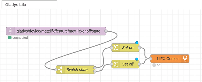

Super clean! And by the way, does the LIFX Node-RED integration work well? :slight_smile:
We shouldn’t hesitate to create small tutorial add-ons on the forum for certain technologies with the actual Node-RED JSON exports
That’s the goal!
After releasing the curves on the Dashboard, gauges could really be a next step
Nice, I already have quite a few workflows on Node-red, I need to watch the video but it could be great to reconnect my Yeelight to Gladys :grin:
The lib isn’t that new and it’s rather basic

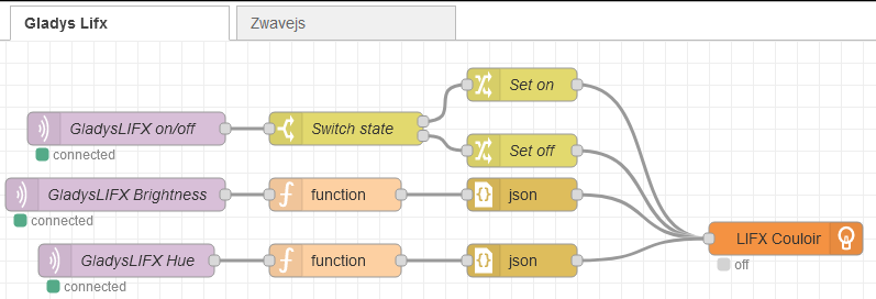

I have a question (no info in the doc)
I tried the hue feature on the bulb via MQTT and it seems there’s an oversight because this feature is not manageable in the dashboard.
So I used color, what is the format? RGB, HEX?
I think it’s an unused remnant, we only use the « color » feature now.
We use a format derived from RGB, stored as an integer value
We have conversion functions to/from HEX and RGB in the Gladys utils file:
You can use this function in Node-RED to convert to/from HEX/RGB depending on what you retrieve.
