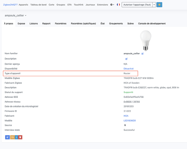

Indeed, to have a reliable Zigbee network, you need good mesh coverage!
At my place, all my bulbs are IKEA ones that act as routers:
