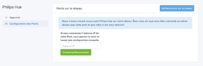

I’ve started working on improving the Philips Hue scan by:
adding the N-UPnP scan (but this requires an additional request to retrieve the serial number)
adding the ability to enter an IP address manually from the front end
I need help with 3 things:
the design of the front-end form. I tried it in a card, in a form, it’s still ugly
I can’t set a value bridge.ipaddress from an input and use it later. It seems basic but I’m stuck (in SetupTab.jsx)
I can’t test it for real because I don’t have a Philips Hue bridge anymore
The branch is here: feat(philips-hue): N-UPnP Search + manual configuration from IP · cicoub13/Gladys@df3fe52 · GitHub

Hi @cicoub13 So cool, thanks for the PR!
Maybe you could reuse the format we have on the other integrations?
A « + » button next to « Search on the network », which would add a card (take inspiration from the design of the other device cards)
I recommend reading code from other places in Gladys to understand
Example for the dashboard page, we create a function: Gladys/front/src/routes/dashboard/index.js at master · GladysAssistant/Gladys · GitHub
Which is then passed as props to the component: Gladys/front/src/routes/dashboard/index.js at master · GladysAssistant/Gladys · GitHub

Good news,
I had reported the detection problem a long time ago.
For some it worked well and for others not at all.
The frontend and backend are working
An image is available to test:
Scanning and adding still work
N-UPnP scan works for people who previously had issues
Manual IP addition works
Device control (lights) still works (because I tweaked the storage of the bridge configurations a bit)
docker pull cicoub13/gladys:philips-hue-improve-scan

PR ready (tested by an English-speaking user)
master ← cicoub13:feat-philips-hue-improve-scan
ouvert 10:52AM - 30 Oct 23 UTC
### Pull Request check-list
- [x] If your changes modify the API (REST or Node.js), did you modify the API documentation? (Documentation is based on comments in code)
### Description of change
Following multiple issues about Philips Hue discovery, this PR allow to:
- Enable both N-UPnP and UPnP search
- Allow user to manually enter Philips Hue local bridge IP address to configure it
TODO:
- Improve documentation (to explain that bridge should be registered through Philips Hue Application before using N-UPnP search)
- Improve documentation to add the manual configuration
- Ask for users to do real test use cases (Docker image under build)
