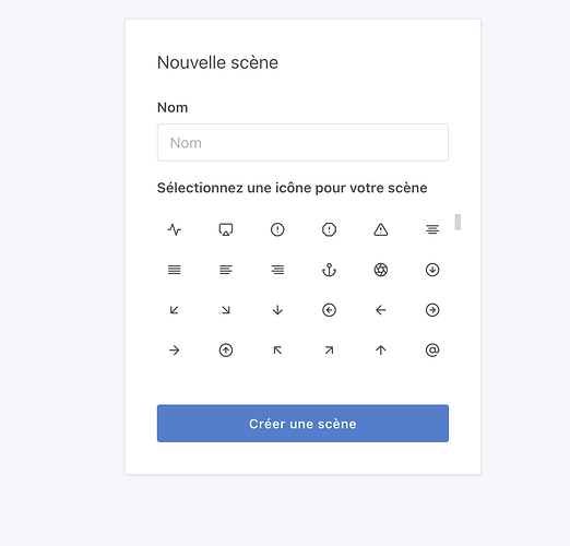

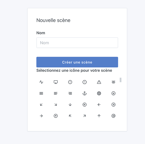

After these two little things, it’s good for me to merge! Can’t wait to publish this
Edit: Ah wait, small regression on the « New scene » view:
Before:
After:
It looked cleaner before, didn’t it?
Hizo
November 16, 2023, 1:51pm
69
Yes it’s better with the button at the bottom
It doesn’t visually bother me, but the button at the bottom makes much more sense.
The flow is Name > Icon > Confirm.
