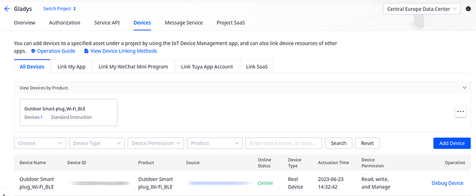

@pierre-gilles : And here is the result in Gladys :

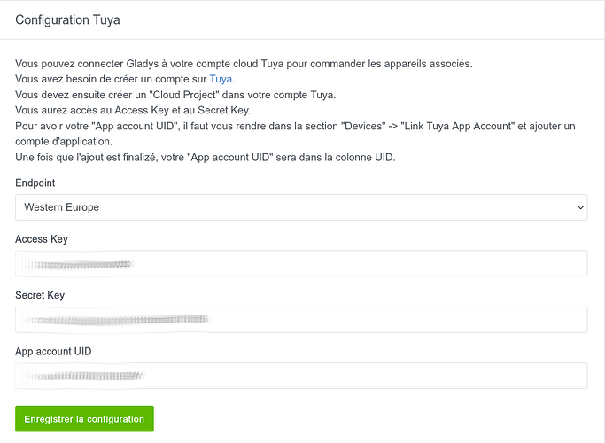

Could you show me your configuration in Gladys ?
Could you send me the Gladys logs when you click the button to scan the devices ?
Hello @Lokkye,

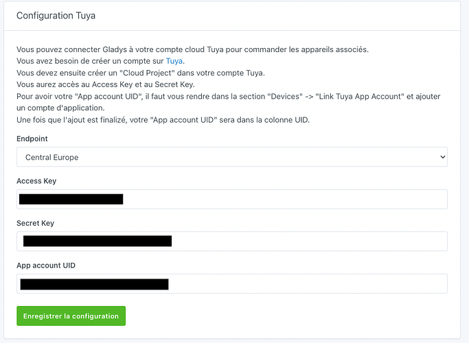

The configuration in Glayds :
@PhilippeMA: The Tuya account is configured to Central Europe (which is very good) but on Gladys it’s configured in Western Europe — could you change it to Central Europe and tell me if that fixed the problem?
The error message is the same.
I have this message on the configuration screen and on the scan screen.
What can I do to help you?

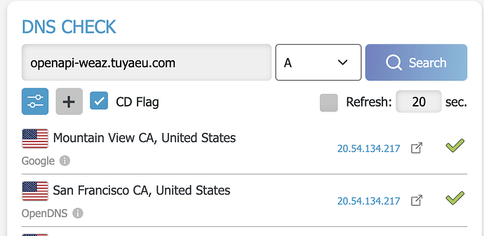

FYI, this error is a timeout during DNS resolution.
The domain is, however, valid:
@PhilippeMA don’t you have a network configuration or a DNS blocker configured on your machine or your network (like PiHole)?
No, none that I’m aware of. Is there a way to check using an app or a command?
