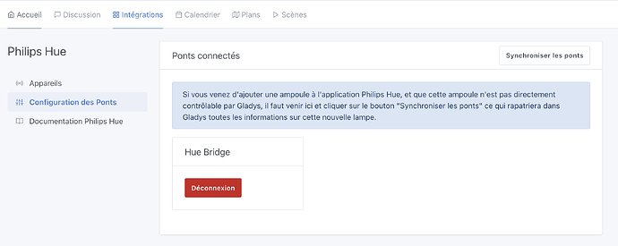

I encountered this bug yesterday, and I made a PR to fix the issue
I added a button in the interface that allows re-synchronizing Gladys with the Philips Hue bridge:
master ← add-philips-hue-sync-with-bridge-button
ouvert 01:49PM - 29 Apr 24 UTC
### Pull Request check-list
- [x] If your changes modify the API (REST or Node.js), did you modify the API documentation? (Documentation is based on comments in code)
- [x] If you are adding a new features/services which needs explanation, did you modify the user documentation? See [the GitHub repo](https://github.com/GladysAssistant/v4-website) and the [website](https://gladysassistant.com).
- [x] Did you add fake requests data for the demo mode (`front/src/config/demo.js`) so that the demo website is working without a backend? (if needed) See [https://demo.gladysassistant.com](https://demo.gladysassistant.com).
### Description of change
Fix #2062
Better late than never
