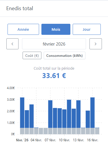

On the Enedis integration, I noticed that in the month of February some days the cost was zero:

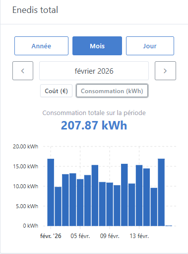

Whereas the consumption is present:
I won’t rerun the cost calculation for now so I can have data to diagnose.

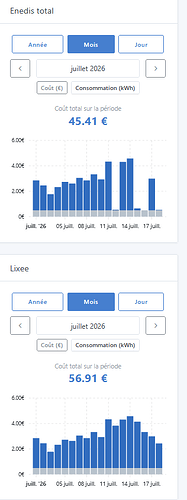

Personally, I’m experiencing an interruption in cost calculations for a few days after February 1st due to the pricing change.
But I’m eagerly awaiting the integration of @Terdious ’s development for the custom calculation (development tested, proven and validated by me ).
I have the same issue!
I think there are days when Enedis provides the data late, and so the calculation has already run.
Currently, we assume that at 11 a.m. Enedis has sent the previous day’s data, but on some days it’s probably later.
Maybe we should run another round of calculations later each day to be safe!

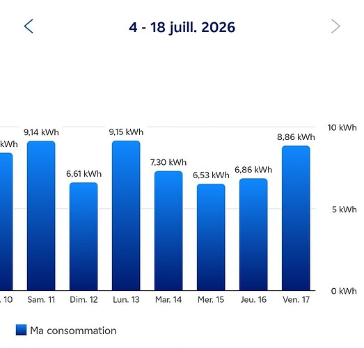

I’m reviving this topic because I notice that I still have the problem with the Enedis integration:
Thanks for the nudge @prohand ! I had already added a recalculation, but apparently it wasn’t enough.
This time, I’ve implemented something more robust: after each synchronization with Enedis, if new data is retrieved, the consumption is automatically recalculated. That way, no more gaps in the racket!
