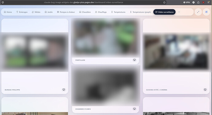

I have an issue with the camera and home widgets.
The images are not adjusted to the widget in desktop browser mode (while it’s okay in responsive mode on my phone):
Camera: the images are cropped and zoomed in
Home: the imported photo is not resized to the widget size (the photo overflows, unlike the camera).
Is anyone else experiencing the same issue?

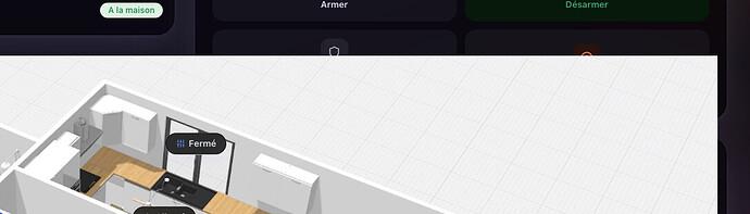

I also have a problem with the home view widget.
Since it overflows at the top and bottom, you can no longer click on the icons on the right:
guim31
August 28, 2026, 6:47pm
3
I think you just have houses that are too big!

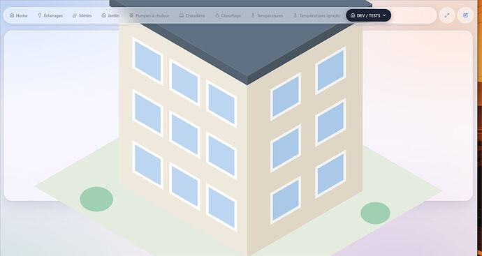

chez moi je n’ai carrément plus rien après avoir sélectionné la maison :
For webcams, images are no longer cropped (even if the widgets don’t all have the same size while all images are in 16:9).

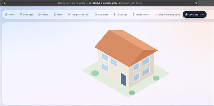

For the home widget, no changes:

It’s all good. For the cameras, I now have black bars (the widgets are not properly sized) but the images are no longer distorted. And for the custom widget, it’s perfect.

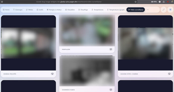

I’m going to be annoying, but I preferred it before. For the camera in the middle, the widget adapts to the area and I have large black areas. I’m not a fan.

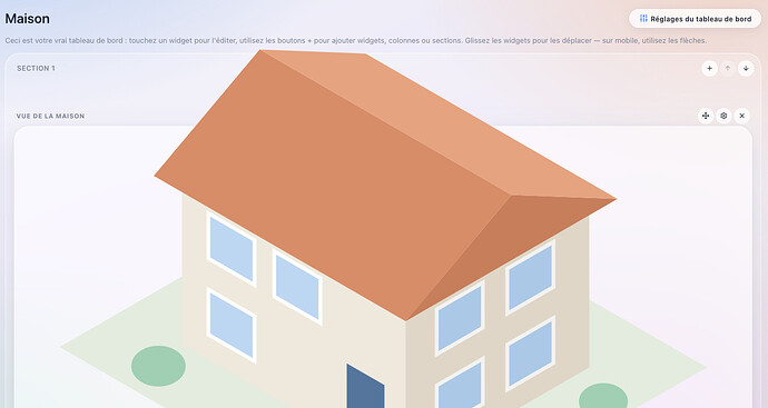

ok for me for the house:

I agree, it’s not great!
The solution would be to simply not dynamically reframe the cameras, and too bad if it leaves a hole in the column:
I pushed a new version to the same URL

Here is the result on my end. I have a 3-column layout;
It’s good for me now for the cameras
