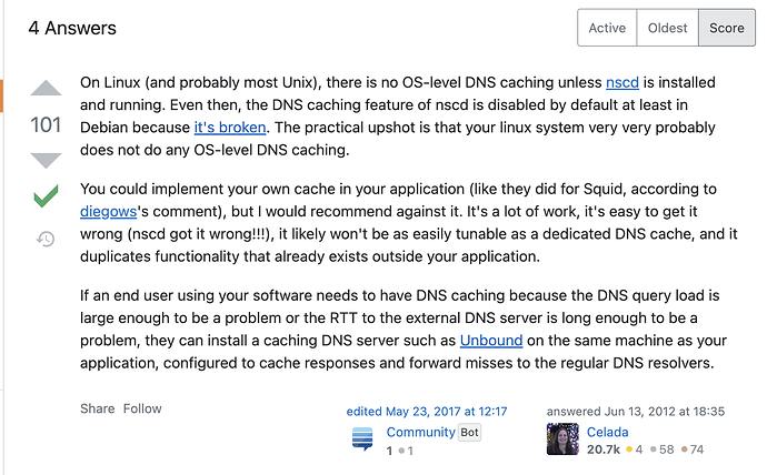

I came across comments like this:
So I understand better why the TTL is not respected (both in the Docker Alpine image and on the Debian of Raspberry Pi OS), it’s not a bug, it’s by design on most Linux systems
