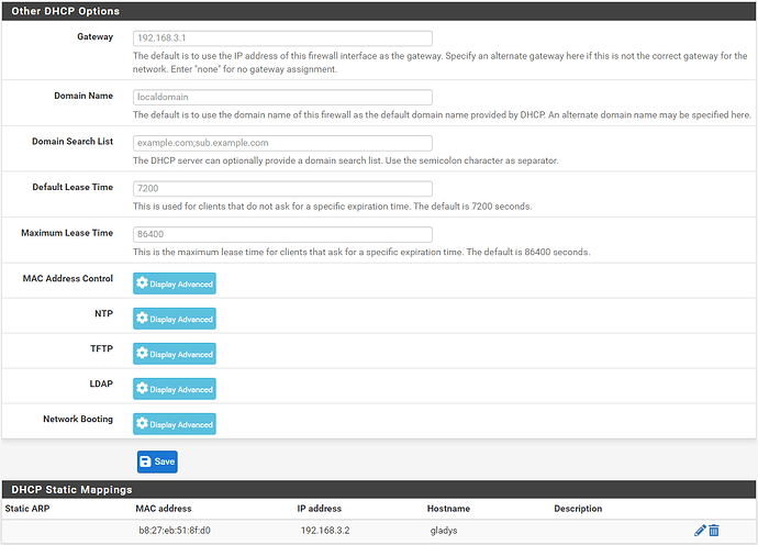

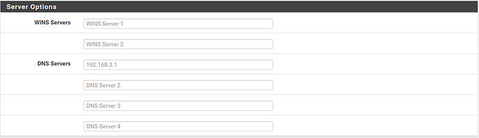

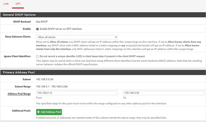

First, you should restrict your IP range (how many machines can connect in total?) then check that there aren’t static leases assigned within the DHCP range, your range end is .254 — what are the DHCP configuration settings? Post screenshots
Thanks for DynFi — I didn’t know about it, very interesting!
For the DHCP server, here are the settings:
I did create a static mapping for the Pi

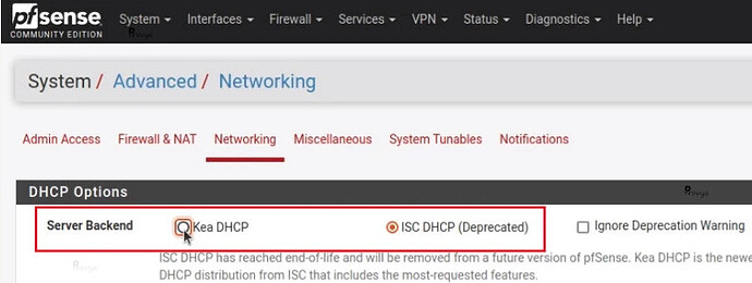

go through ISC DHCP, restart your pfSense and then your Pi to see if that resolves the problem
Unfortunately this does not solve the problem…

And in Node-RED what does it show after switching to ISC DHCP?
As you can see, still no localhost connection…
