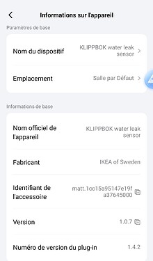

Yes I tried several times to add the four Bilresa remotes via the Aqara app, it always times out with « network access failed » — see my screenshot.
However, I was able to add via the Aqara app an Alpstuga air quality sensor (which I’m going to return, because I don’t find it very practical), and a Klippbox water leak sensor.
So there is clearly a problem with the Bilresa remotes, I’ll follow the indicated post, thanks.

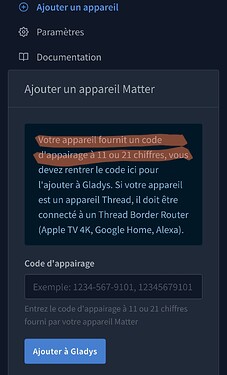

How are you trying to add them to Gladys?

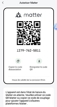

You must not use the code on the bulb, but a « share code » that Aqara usually gives you :slight_smile:
So I stupidly read the prompt here :
In my Aqara app there is only this for, e.g., my water leak detector :
I don’t know where to find this « sharing code ».
Thanks!
That’s right, the text in the Aqara app says « Or copy this pairing code to add the device to other Matter platforms »
So it doesn’t work then?
Is the device online and controllable from the Aqara side?
Ok I understand, I thought it was the same code as the pairing one… :winking_face_with_tongue:

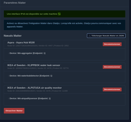

I was able to set up my Aqara M100 and import it into Gladys, that’s good, and it appears under « Settings ».
I then imported a device (in this case a water leak detector) and I thought it would appear under « Devices » and not under « Settings » as shown in my screenshot.
If you already have an explanation for this :wink:
As for the rest, I’m scouring the Aqara forums, but I can’t find anything and all the IKEA devices won’t connect. I really think these devices are unfinished, and I’ll look into replacing them.
For this sensor, it’s probably that this type of sensor is not yet supported by the Matter integration in Gladys.
If you provide the JSON file by clicking the « Download Matter Nodes as JSON » button and sharing it on https://pastebin.com/ I could confirm that for you :wink:

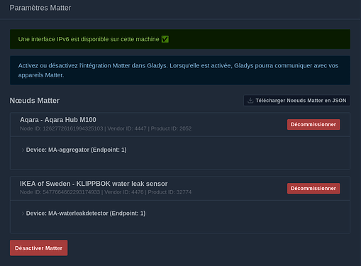

For information, note that this time the leak detector has been added as a child device of the M100; I don’t know if that makes a difference, and an air sensor has been added as a node:
and only one device is reported:
