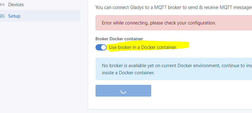

What is supposed to be fixed is the detection of Docker, for MQTT integration, for example
I continued debugging
cgroupv1 and v2 are not the same story
I managed to make the docker part work by cheating

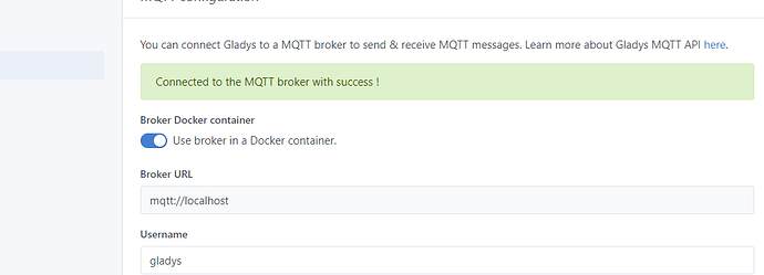

Result:

Well, I went back to the hacky method with a grep/sed that handles both cases (tested in cgroup v1 and v2)
https://github.com/GladysAssistant/Gladys/pull/1434
There’s nothing better than this method in the end :slight_smile:
Does it work with both versions, on both Debian 10 and 11?
If so, that’s great!
Yes in both cases, the current instances are therefore not affected.
