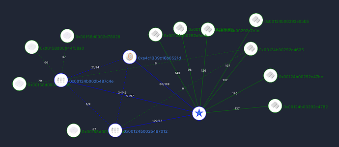

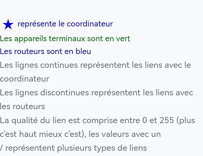

How do you interpret the dotted lines vs the solid lines on the diagram?

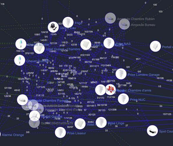

Aside from the plugs, when I re-pair a device I can see the dotted links to the plugs (secondary routers), but as soon as I re-pair another device only the second one has the dotted links to the plugs — the first has « lost » them, at least according to the z2m map.
Also, I haven’t yet found where, in the details of the device that appears with these two dotted links, you can see those two links. It’s as if during network discovery to generate the map the protocol had access to information that it didn’t display afterwards.
Furthermore, I’ve never observed a link being formed outside of a pairing process. That might be related to the models I’m using as well.
Example: a sensor with dotted lines to two plugs, and a solid line to the coordinator. I unplug a plug, wait 5 seconds, replug it, refresh the map. It will never find the link to the previously unplugged plug. Maybe an option to enable on the device, or a firmware to update, or just the device models…
Sometimes the dotted links show an LQI of 0 on the map. How can an established link have zero reception? :sweat_smile:
I’ll keep digging :books:

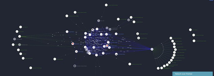

Did you invite Luke and the whole Star Wars gang into your living room @guim31?? Are you planning to take over all those planets?? :joy:
Visually it’s pretty crazy ^^ 65 Zigbee devices!!
