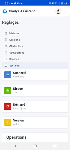

150ms on PWA 4G
@VonOx Are you sure you’re running the latest version of the frontend? (Sometimes it takes 1-2 refreshes for the PWA to update)
To check, in the latest version the ping refreshes every 2 seconds without touching the page.
If that’s not the case, you need to do a proper hard-refresh :slight_smile:

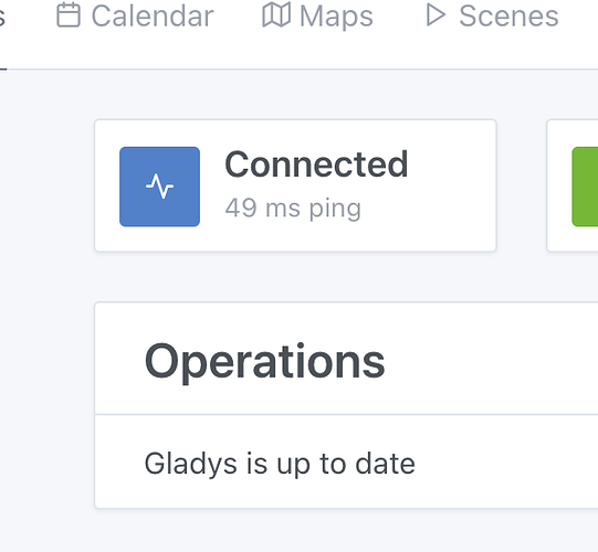

Nice!! :slight_smile:
Well, that’s good, 60ms is what I also notice.
This is mainly « uncompressible » network time, because if you notice 24ms locally and 61ms remotely, that’s an additional 40ms for the round-trip, which doesn’t seem unreasonable :slight_smile:

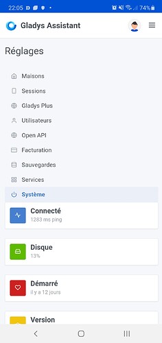

In the meantime, my current pings:
1283ms ?? That’s huge!
Are you sure you have the latest version of the front end and not a cached version? (See my message above)
